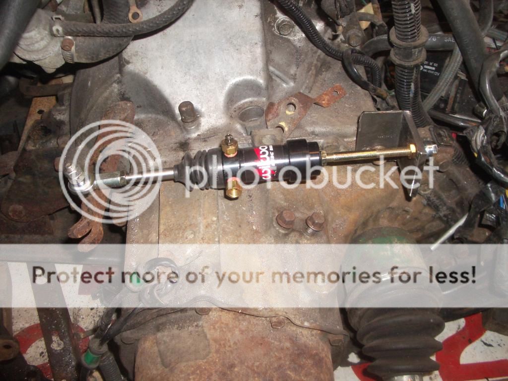

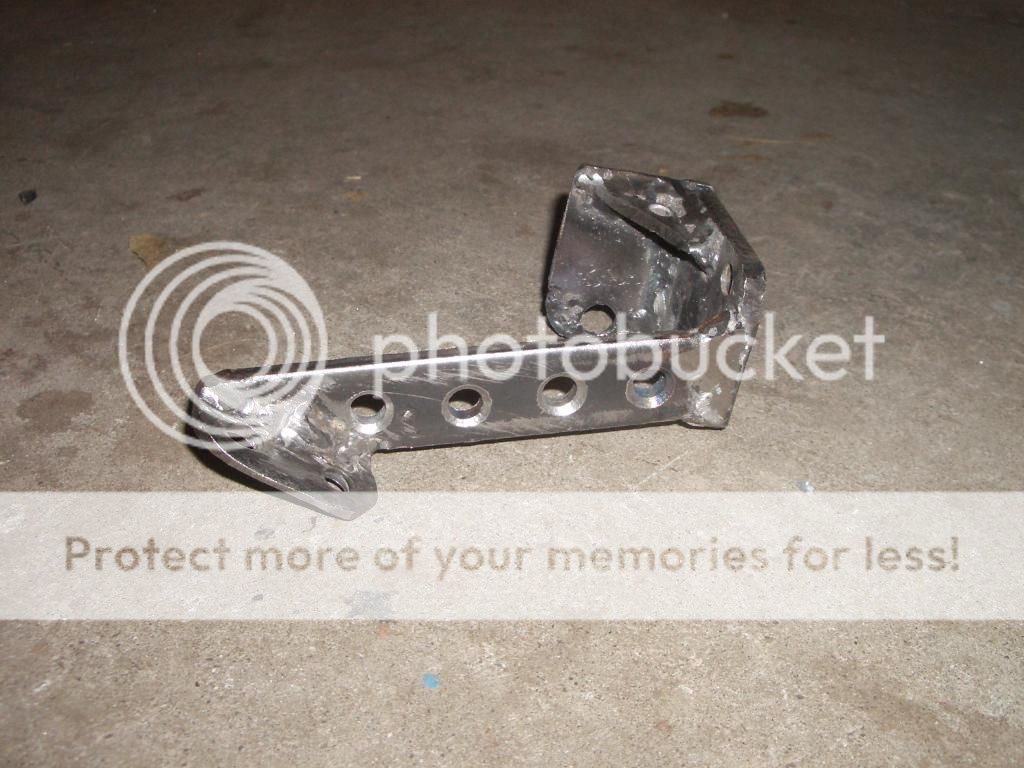

Additionally, switching to a hydraulic slave cylinder at the trans isn't hard at all.  Wilwood makes a really nice "pull-type" slave cylinder that you can fit without too much trouble.
(I'll replace that 5/16" bolt with a grade 8 bolt)
Make a bracket with some good bracing and it should work fine:
So there ares some possibilities for the axle shafts for you and the clutch / slave cylinder mods are easy and will cost you around $100.
