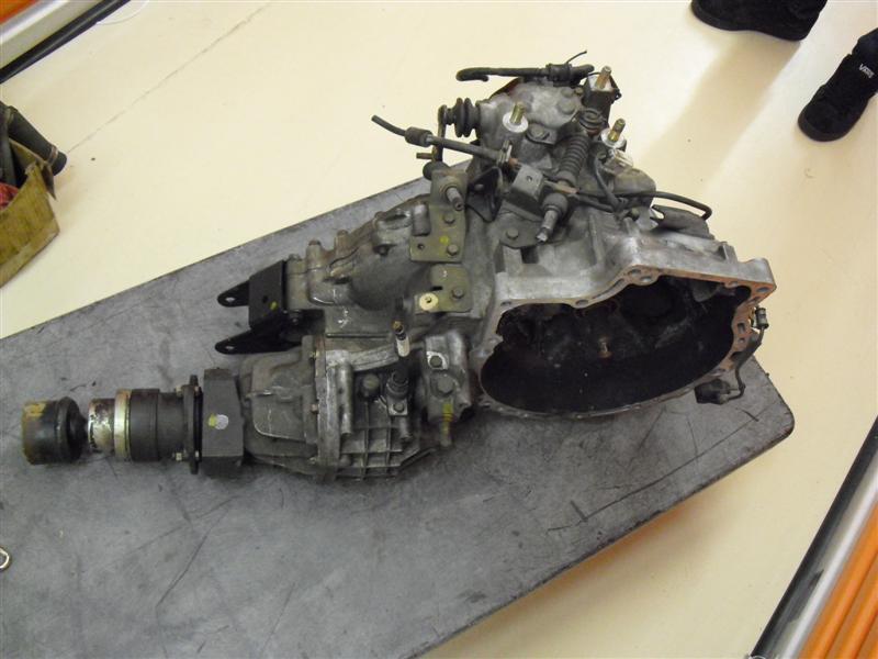

Soooooo a little bit of an update.
Picked up a BP GTX awd transmission (only available in japan, mated to the BG GTX w/ BPT)
Its going to be a lot of work to install it but shouldn't be too bad considering everything I've been through so far-
This AWD tranny's a bit stronger than the one I have now... means I can turn up the boost... Look out Joe
Along with this going to put some internals into the engine and probably upgrade the turbo...
Going to work on the Megasquirt too...
And I'm keeping an eye out for a good deal on a Miata LSD to throw in the rear. Will play nicely with the VLSD center and 40/60 F/R torque split
Thats all for now. I'll update y'all when more comes along
